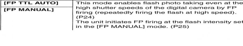

Well, I got a $45 dollar flash from Amazon and no surprise there isn't a way to defeat the GH2's 1/160 shutter speed limit when used with a flash. I did some more reading and found a new/used Panasonic DMW-FL360 flash that has a FP TTL mode which, according to the manual here says that I should be able to set the shutter speed higher.Manual.jpg
