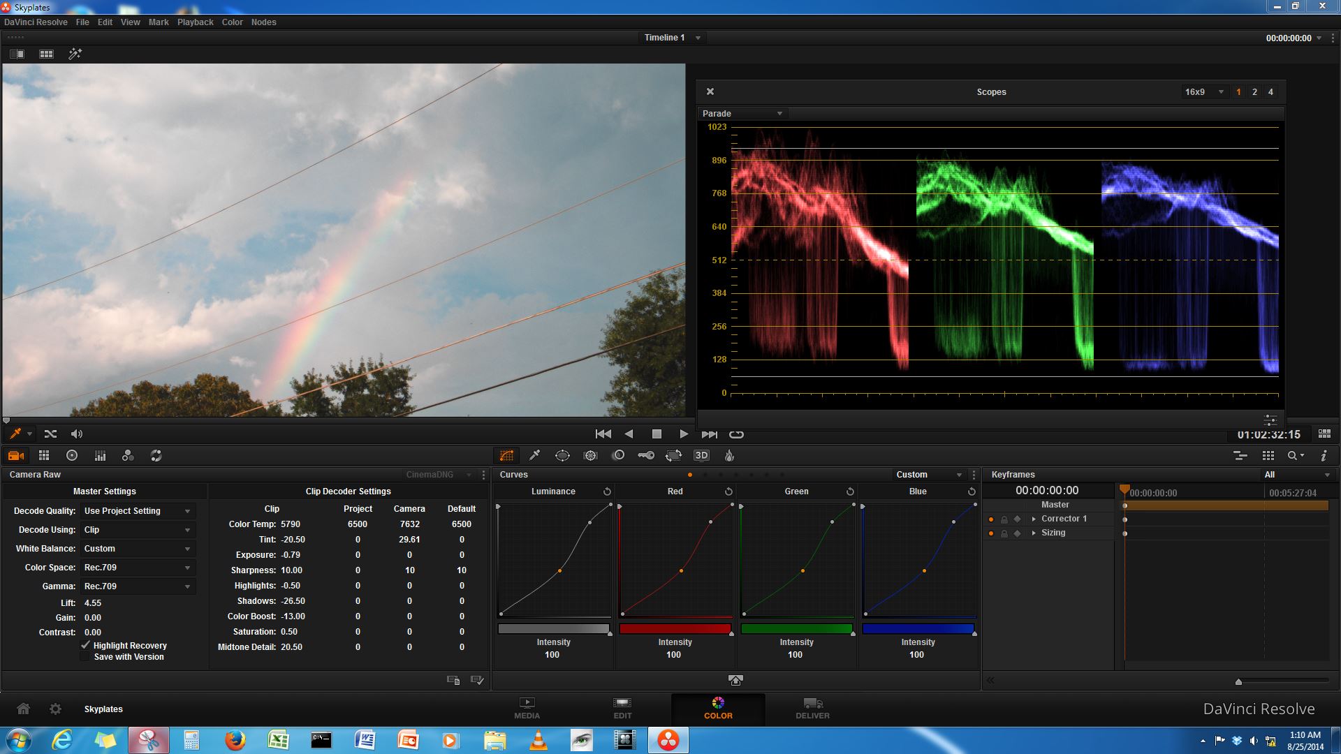

A recent near sundown sky shot from my neighbor's driveway shows the DNG range vs 709 legal video pretty well. This was a correctly exposed ETTR raw clip, very hot but not clipped in the raw file.
Color space and gamut in Resolve were set to REC709. The first picture shows the image as imported. The second as corrected by the scopes to REC709. I'm still very much a neophyte when it comes to Resolve. This was a direct approach using the new dng raw tools and a gamma curve correction only. No luts.

All valid criticisms. The second shot is a stop overexposed with some clipping, but there is still plenty of room to pull up shadows. The cyan cast in the first shot is very close to actual sky color, happens sometimes at that altitude after late afternoon thunderstorms. You get odd refractions from the moisture in the air.
