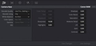

Downloading now, so haven't tested, but the changelog for Resolve 15 specifically calls out "Support for Camera RAW controls for Canon RAW clips". I'm assuming this extends to Canon RAW Light, too. Will report back when installed and tested.
https://forum.blackmagicdesign.com/viewtopic.php?f=21&t=71881
EDIT: So it looks like it's missing WB and Gamma control, but everything else is working in the beta. I'm hoping they enable the rest before release...

Whats the benefit? Wasn't it already technically there through other panels?
Benefit for me is largely workflow simplicity. For example dialing in a kelvin value rather than balancing scopes. Especially true if you're using other RAW shooting cameras along side a C200.
Welp I already notice a huge difference using the RAW Sharpen slider versus the one in the panels. WOW!
