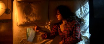

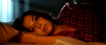

Here's some grabs from upcoming music video (graded outdoor shots have some magenta tint, playing with faded film look):
85 1.8
probably 28-70
18-35 3.5
28-70 2.8
28-70 2.8
