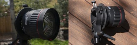

I've been experimenting with the 100w Yuji's myself. This is a prototype for a permanent install that I built using a cheap PAR can as an enclosure with a riveted mount that supports a large 180cm umbrella. Looks absolutely ridiculous but it's small (less than 9" long) and hidden behind the umbrella so no one ever sees it.
I only used simple dimming control via a potentiometer -- would be interested in your controller box if you decide to share. Similarly I'm happy to share a parts list if anyone wants to get started experimenting with building these.
