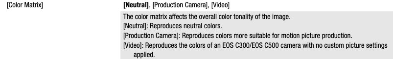

And this is what the manual says:
Yeah, the manual definition is kinda...vague...but that may be all there is to say.
