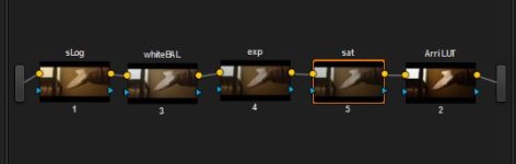

Over the last 8 months I've come to the conclusion (right or wrong) that there's no single best method for grading the sLog footage from the F35. It all depends on what you want to accomplish, what look you're after, etc.. Lately I've been feeling a bit hemmed in by the three or four cineon-to-filmstock output LUTS, so I've been skipping using any input/output LUTS in the Resolve project settings and just using the final node in the grade to apply a LUT. The film look LUTs that ship with Resolve are decent, but lately I've found that my go-to choice is the Arri Alexa LogC to Rec709 3d LUT. It has a nice tonality to the blacks. It does tend to push the exposure & saturation a bit hot, though, so I put serial nodes in the grade to correct for those. My basic F35 sLog grade has the main slog node, a white balance adjustment node, an exposure adjustment node, a saturation adjustment node and a LUT node. If I need to pull secondaries I insert a node before the LUT node to do those operations.
Here's an example using one of my many silly low-light tests:
sLog from the camera...
Grade node flow...
Graded result (using the Arri LUT with node mods for WB, exp & sat)...
But, as mentioned, there are many ways to skin this cat. This is just one way of doing it. I'm sure that a high end pro colorist or pixel peeper could rattle off a grocery list of issues with this approach (and I'd gladly learn from them if they did), but for the stuff I'm doing it works for me. YMMV.
-k
ps: you don't need to use a separate node for each operation. I just do that so I can keep track of what I'm doing more easily.

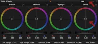

The colour window section must be set to "Log", not "Primaries", then play with "offset" wheel and you can balance the colours easily (usually a pull towards blue gets it right)
Hope this helps
