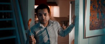

Here's a framegrab from a short I DP'd back in April. GH4/Shogun combo, lit with a handfull of LED panels.
This shot in particular is through a Rokinon 24mm. I wouldn't call that a great lens, but it did quite well!
If you're going for a Noire/70's/Vintage style look, I'd put the money into getting whatever's within the frame perfect. And stick with the GH4. Maybe get some kind of diffusion for your lenses. I've heard good things about the Tiffen ones :) These may help you get that soft 70's look.
You're also better off lighting with lots of shape, color and shadows, rather than lighting flat... Especially for the Noire-type genre. Decide for yourself where the light sources are, and make them strong and dominant. Anything else in the shot which is not relevant to the story, keep it dark or maybe even black. Use the "not so great" DR of the GH4 to your advantage and deliberately cut away light from dark spots. As for the above shot; we went crazy with mixing color temps, giving more light to the warmer tones, and less to the cooler ones.
