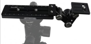

I feel it absolutely needs to be supported (I use the 70-200 Nikon often) There are other way to support heavy lenses if you do not want to go with a 15mm rod set up. check out the image (not sure if I should link Ebay sales here, just search for long lens support) you mount the lens for on the long plate and support the camera (smaller and lighter than the lens) with the adjustable arm or bracket If you are a little bit handy you could easily refit the bracket part to the long tripod plate of your choosing or just add QR clamps to it (front and rear) to match the lens plate and camera body plate you have. Best part of these systems is that they place the camera on the tripod at the balance point, many 15mm rod systems with large lenses end up really front heavy so you can't balance the camera/lens on the fluid head

That's interesting. I can't find it though. It's OK to put product links up. They just don't want people selling there own stuff stuff here and pestering people without prior permission.
