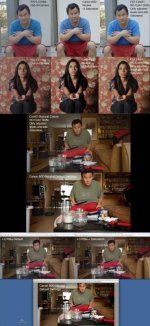

Here's my tests (I'm the ugly Asian dude and the Hispanic / Black girl is my wife). I do feel like Canon has a nice color science that carries across all their cameras, so I'm hoping the C300 will have similar matching results with the 60D since I have to match it with the FS7 on an up-coming shoot.
Here's a bigger version since DVXUser only allows small-ish images
http://www.builtbyugene.com/images_client/SonyCanonTests_01.jpg
I did no color shifts in any of the images. The FS7 LC709a is straight-out-of-camera. The FS7 CineEI has no color shifts, only adjusted levels and added saturation since it's a flat S-Log3 image. I wanted to show the true colors from both cameras. Even with no color shifts, I feel the CineEI is pretty close to the Canon 60D. If I shifted some colors they would be a really, really close match.
For the 60D I used Neutral default on the bottom tests. and took Saturation down -3 in the top two tests. The default saturation of Neutral is a bit high for my tastes, so I went with -3 which I feel makes a nice out-of-box Canon image.
I'm not going to go into this whole "Camera X is more cinematic than camera Y." I will say this though. The MAIN thing I missed when I switched from Canon to the FS700 almost 3 years ago, is the nice out of box look that Canon has. I have to commend Sony for Cine EI and LC709a since they finally came up with a very nice out-of-the-box look. The FS7 is a huge improvement over the out-of-box looks from the FS700 and the F3, which could look like plasticy without grading.
I feel like CineEI can match pretty nicely with Canon color science, especially with some color shifts which I did not do. Sony tends to go a bit more blue while the Canon's are more focused on reds. Canon is a bit more punchy out of the box, while Sony is a little more subdued. Both cameras have a nice color science IMO, just different ways of presenting it.
