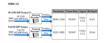

Looking at Canon's website for the XF400 - it does list 4:2:2
There's a chart on Canon's site that shows all internal recording across the board at 4:2:0.
Then there's another one that shows 4:2:2 via HDMI and I figured it would be HD and at least 4K/24p/30p, but it looks like 4:2:2 only applies to HD.
