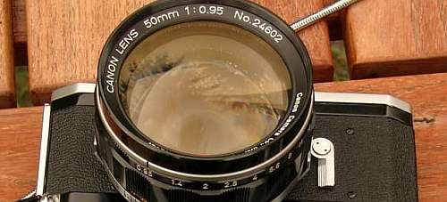

There are some things to consider when using this lens with the GH1...
There are two versions of the 50mm f/0.95. One is made for the Canon 7 rangefinder bodies and the other is a "TV" lens. Both lenses are optically the same, however the "TV" lens aren't designed for the Canon 7 rangefinders and loses functionality when mounted to them (not much of a concern for a GH1 user).
What's important to consider for mounting these lenses on a GH-1 is the mount. The f/0.95 is designed for the unique external mount of the Canon 7 so you won't find any adapters for it.
There are two solutions for this, and they are both relatively simple:
1.) The first is to use a C-mount adapter. The "TV" lens came with a C-mount adapter (which also acted as a rear lens cap), and the same adapter also fits the normal lens as well; the adapter usually goes for around $60-100. From there you can just use the C-mount to µ4/3rds adapter to use this lens on your GH-1.
2.) The second method is to have a converted lens. The popularity of this lens means that there are a lot of Leica M mount conversions for this lens. The converted lenses tend to be more expensive online, but you can have any lens converted to an M-mount for around $150-200. From there you just use an M-mount to µ4/3rds adapter to fit the lens on your GH-1.

It's a very different lens compared to other Nikon/Canon primes. Its very soft wide-open, almost 'dreamy', which is fitting since they called it the 'Dream lens'. When stopped down its fairly sharp, but I wouldn't say as sharp as the modern Canikon lenses. The whole point of this rather large chunk of glass is that lens exceeds the perception of the human eye when used in available light photography. There are some samples Flickr samples posted previously in this thread, I would go look at that to see what type of photos to expect from this lens.
You have three-choices:
1.) Get the TV-lens (which came with a C-mount adapter). Then use a µ4/3rd to C-mount adapter to mount it on your Panasonic.
2.) Get the normal lens for the Canon 7 rangefinder, and buy a C-mount adapter that fits this unique mount and turns it into a C-mount, then use a µ4/3rd to C-mount adapter to mount it on your Panasonic.
3.) Buy either lens, and convert it to a Leica M-mount (links in my previous post) and then use a µ4/3rd to Leica M-mount.
Canon 50mm F/0.95 C mount adapter

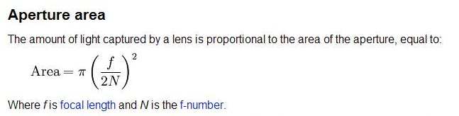

Sorry if this has been mentioned before, but how have Canon made a lens which has more light exiting the back than entering the front? I thought f1 was 100% light transmission , f1.4 one stop less etc. So how does f0.95 work?
No, it isn't so - look ... 100% light NEVER comes out! glass eats light :D
http://en.wikipedia.org/wiki/Aperture
or
N = ( f/2 ) * sqrt ( pi / A )
or
radius (aperture) = f / (2*N) = 5 / (2*0.95) = 2.6316 ... radius of max. aperture
then N = (5/2) * sqrt(pi / (r² * pi)) = 2.5 * sqrt (1/r²) = 2.5 * sqrt(1/2.6316²) = 0.95 :tongue:
