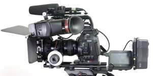

I am just starting to build my custom rigs for the C100.
I find relocating the handle a great help on the shoulder. I will be selling these kits in a week or so, I am still perfecting all the parts, The VF can be anything but I really like the Alphatron. I have the IDX battery outputting power to the C100 and NanoFlash/ other recorder.
The kit comes off quickly and is really quite compact, and it is modular, you don't need the Ninja and Battery cheese plate, FF, or matt box. But when you do add them. I will be making an even more compact version as well.

The last 2 photos was the setup when I tested both the Ninja and NanoFlash outside, I will publish some videos from that compare soon.
For light, the Zacuto EVF cannot be beat. It feels plastic-y and cheap, but it works great. HDMI only (sad), but still, very light. I don't think you can get any lighter with an external EVF than by going with the Zacuto one.
However, I am a fan of the Alphatron.
plan to try using the ninja 2 as the EVF when they realease the loupe for it

As far as pricing goes it will be similar to my other kits.
I agree that the Zacuto is very light and quite nice. However the Alphatron is more rugged and I like the menu structure more and the image is the best of the bunch in my opinion, the most like a real built in one on a full size cam. I am sure there will be many more available soon and my kit will accommodate all of them.
I am using the Zacuto relocator on my own Rail adapter right now, I will probably offer the Denz version as well. There is not much point in me making one seeing how there are already 2 versions available at a very reasonable price really, they are complex. I was going to make my own but it does not make sense for me anyway.
One thing about the Ninja interface is it is only touch screen, so a loupe would have to flip up easily. Though the Ninja 2 with the latest firmware is supposed to support the HDMI record trigger, this would be great.
Bear in mind the Ninja does not offer Zebra or peaking, so it is of limited use, and if you output the C100 peaking etc from the camera the Ninja records it. The reason I love the Alphatron is that it has great focus and exposure aids built in. However it has no way of showing if you are recording or not (prove me wrong on this and I would be happy). It is also HDSDI and HDMI and it loops the signal so you can use the Ninja with it. The NanoFlash can output HDSDI even if the incoming signal is HDMI this is a neat trick, and it also shows in the EVF if you are recording on the NanoFlash, it is also lighter by far than the Ninja and it uses very little power.
My AB or IDX battery plates can power both the NanoFlash and the Alphatron as well as the C100 and an on cam light. This is great because the weight is in the back to balance the rig on your shoulder, I always try to put heavy stuff in the back.
Tried this last night with firmware v4.01 and it works!
The original Ninja doesn't support these but the Ninja 2 has zebra, peaking and false colour.
