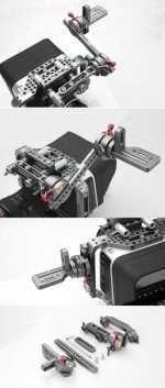

Just recently I have seen this EVF holder by Tilta:
which looks not only 100% sexy but also like it could do the job. The only problem: I am not familiar with NATO mounts.

this looks like a solution:
