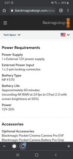

and for the 6k pro:
Power Supply
1 x External 12V power supply.
External Power Input
1 x 2‑pin locking connector.
Battery Type
NP-F570
Battery Life
Approximately 60 minutes
(recording 6K RAW at 24 fps to CFast 2.0 with screen brightness at 50%)
Power
12V-20V.
I'm guessing more like 35-40 minutes for real world usage at best. The grip will be useful for run and gun situations. Anything on sticks or with an easyrig for longer shoot days will of course go the usual pocket cam route of V-locks.
