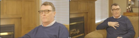

Colour Matching -> Here are a few samples from this past week
S-Log & C-Log - Straight out of camera

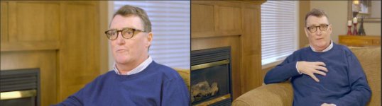

Slight Colour Correct (I'm not a colourist)

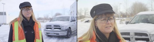

Sample 2 - C-log and PP6 (as I didn't have an ND to be able to do S-LOG outside) - Straight out of camera

Just stuff to look at. Personally, I'm liking how they match so far. This is me shooting both cameras, so quick setups and not sure if I had them white balanced exactly the same (I think the "sunlight" WB on the C100 and the "sunlight" WB on the A7s are a tad different, so using a specific kelvin value works better).
