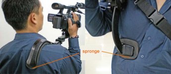

Another thing that came with the shoulder rig was a 2-inch wide adjustable nylon strap that clips to two O rings located where the swivel joint is for the chest support. I had put off trying this strap out, thinking it wouldn't do much, but finally got around to testing it and it works great. The nice thing is that is greatly reduces the weight/pressure that the chest support puts on your body so that the shoulder rig doesn't move when breathing.
With the strap it attached, the shoulder rig also feels much more secure if you are letting go of it with both hands while making adjustments to the camera, mics, light, lens or audio recorder. Here are some promotional pics from the manufacture of the shoulder rig with the strap connected.
Note on the pics: I don't use the elevated piece between the camera and the flat platform, I mount the camera directly on the platform instead.

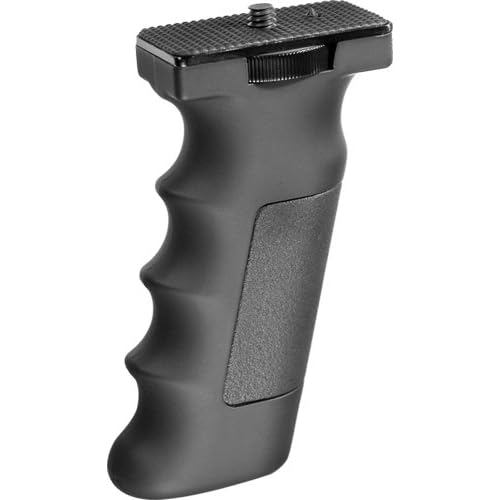

Bottom grip:
http://www.amazon.com/BARSKA-Accu-Handheld-Tripod-System/dp/B001JJCI5Q/ref=pd_bxgy_p_text_b

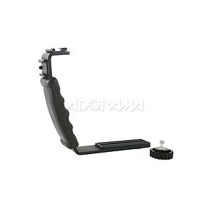

Side grip with shoe mounts. Note that the shoe mounts on this bracket are glued on and not screwed on so they can potentially break off. I broke the top one off and had to super-glue it back on:
http://www.amazon.com/Adorama-Heavy-L-bracket-Standard-Mounts/dp/B002A92OVM
