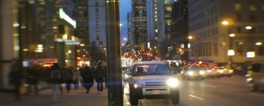

Some of the Chinese CCTV lens like the Fujian Brand, are all metal, so they seem well built. But the shape of the lens makes it very soft on the edges unless you stop it down to f22. OK for shallow DOF shots but not wide angle, unless you want a dreamy look. This is a shot with the Fujian 35mm f1.7 and Century Optics Anamorphic Adapter.
