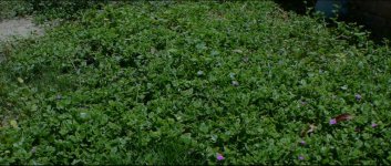

Thanks for checking Barry- I'm getting good detail out of these settings so far. I'm gonna up them a little bit at a time.
Here's a frame from an anamorphic test. Though this level of anamorphic glass is a detail thief; this
added boost in quality to the codec is showing less of that, and giving it as much as it can back.
My Settings are:
54.000.000
58.000.000
68.000.000
GOP: 15 - Deselected as it's 15 anyways.
24P NATIVE
Pappas, that's very similar to the scene I am shooting. If you are shooting on a Sandisk and that is working, do you have another brand card you could try with those same settings and that same scene?
Your settings of:
54.000.000
58.000.000
68.000.000
should be well within a class 10's ability to record.

Well it's not equal and never can be because enabling or disabling Native 24p makes things unequal.
Everything else is equal.
Here is my exact sequence:
1. camera set to 1/50( also tested 60,125), 200 ISO(also tested 100, 250, 300, 640) FHD/HD(both give exactly the same errors in the same way).
2. camera set on tripod, focused at grass, NO movement, exposure set to 0.
3. class 6 and class 10 cards record normally with stock firmware. NO Native 24p.
4. class 6 and class 10 cards record normally with only "A" bitrate settings. NO Native 24p.
5. class 6 and class 10 cards record normally with only "B" settings. NO Native 24p.
6. class 6 and class 10 cards record normally with only "C" settings. NO Native 24p.
7. class 6 card FAILS and class 10 PASSES with these settings verifying that bitrate is truly higher than Class 6 card can handle. This was intentional and proves that the bitrate settings are truly working.
no native 24p
64M
72M
80M
8. Did not test above 80Mbit.
9. class 6 and class 10 cards PASS with stock firmware bitrate settings and Native 24p enabled while camera is moving.
10. class 6 and class 10 cards PASS with "A" settings and Native 24p enabled while camera is moving.
11. class 6 and class 10 cards PASS with "B" settings and Native 24p enabled while camera is moving.
12. class 6 and class 10 cards PASS with "C" settings and Native 24p enabled while camera is moving.
13. class 6 card fails and class 10 PASSES with these settings verifying that bitrate is truly higher than Class 6 card can handle. This was intentional proves that the bitrate settings are truly working.
native 24p enabled
64M
72M
80M
Camera IS moving
14. class 6 and class 10 cards FAIL with stock firmware bitrate settings and Native 24p enabled while camera is NOT moving.
15. class 6 and class 10 cards FAIL with "A" settings and Native 24p enabled while camera is NOT moving.
16. class 6 and class 10 cards FAIL with "B" settings and Native 24p enabled while camera is NOT moving.
17. class 6 and class 10 cards FAIL with "C" settings and Native 24p enabled while camera is NOT moving.
18. class 6 and 10 cards FAIL with these settings:
native 24p enabled
64M
72M
80M
Camera NOT moving
19. class 6 and class 10 cards FAIL with stock firmware bitrate settings with Native 24p enabled and GOP=12 while camera is NOT moving.
20. class 6 and class 10 cards FAIL with stock firmware bitrate settings with Native 24p enabled and GOP=13 while camera is NOT moving.
21. class 6 and class 10 cards FAIL with stock firmware bitrate settings with Native 24p enabled and GOP=14 while camera is NOT moving.
22. class 6 and class 10 cards FAIL with stock firmware bitrate settings with Native 24p enabled and GOP=15 while camera is NOT moving.
23. class 6 and class 10 cards FAIL with stock firmware bitrate settings with Native 24p enabled and GOP=16 while camera is NOT moving.
24. class 6 and class 10 cards FAIL with stock firmware bitrate settings with Native 24p enabled and GOP=17 while camera is NOT moving.
25. class 6 and class 10 cards FAIL with stock firmware bitrate settings with Native 24p enabled and GOP=18 while camera is NOT moving.
As you can see, it's related to the 24p patch and having a perfectly static scene. And YES, I understand that a Sandisk card would essentially make this work, but that's not the point. The point here is that bitrates clearly within the Class 6 and Class 10 card's ratings are NOT working with the 24p patch enabled and a static scene yet they DO work while the camera is moving. Even holding it by hand is enough to make it work.

This is very interesting, Svart. I took Pappas' advice and shot a full-screen Star Chart (http://www.bealecorner.org/red/test-patterns/star-chart-bars144-600dpi.png) with 20mm lens and GH1 mounted on a tripod with the following settings:
60000000
62000000
70000000
And got the famous "Motion Recording Stopped due to Card Speed" error within a couple of second (I've never seen it before). StreamEye reports 57 Mbit/s avg bitrate on such footage. Interestingly, when shooting the chart hand-held (with associated micro-movement) the camera will keep on recording. Shouldn't static scenes have lower bitrates "theoretically" as there is no movement in the image? So there seem to be two issues going on here:
1) Enabling the native patch causes camera to freeze up at bitrates dependent upon the card used and scene composition.
2) At high bitrate settings and when shooting static scenes the bitrate seems to shoot through the roof causing cancellation of recording, but not freezing the camera.
60000000
62000000
70000000
Bingo!
Yes that is exactly what I am seeing. Handheld= OK. Tripod= fail.
That's why I think people are believing that it's the cards or camera, because this failure is exactly the OPPOSITE of what you would think *should* be happening. It would make no sense whatsoever if you haven't seen it yourself.
Try lower bitrate settings, maybe even STOCK settings, and see if you can recreate my failures.
If someone else can recreate my failures on a different camera, then we know it's not MY camera. If anyone can recreate the failures with different cards then we know it's not my cards and it's a legit problem.
EDIT: Svecher, I just did the same experiment with the chart. I installed a firmware with Native 24p Enabled and then I setup the camera in front of my monitor so that the chart filled the camera's VF. I hit record and 7 seconds later I get the speed error!
EXCELLENT. This means we now have a chart that we can all use to test the same way!

Bingo!
I wish I mentioned this before today. I've been using this testing method for years.
Very interesting thing, the only error I have ever had was when it was on a tripod. It was my MJpeg vs AVCHD. The same shot stopped on both AVCHD and MJPEG...
I told you; ""We'll get this figured out...""
