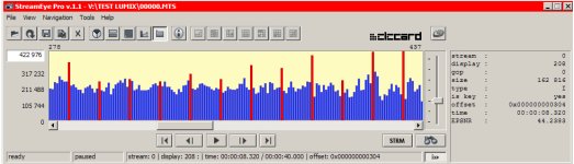

quick report
shooting the chart on tripod seems obtain write error at FHD but over 10 seconds, the longest shoot about 30s.
but no error on SH shoot 1 min, stopped manually.

shoot the chart created high bitrate to the camera initially (according to the streameye figures), as a result we got write error.
meanwhile, it made me understood the limitation of FHD mode. i feel comfort to take it and shoot around cos create this kind of high bitrate scene is not easy.

i patched to NTSC with [50,56,60] and experienced the meaning of unstable. it fail unexpected even normal scene. compare to NTSC, these setting under PAL (excuse that this is my definition) seems stable enough to my useage with almost mud free AVCHD.
Past two weeks, i keep my eye on every footages (i shoot every day) with streameye to see the bitrate reach the max or not. under normal circumstances, it is very difficult to reach the max bitrate expect shooting the chart even tsunami pan on grasses(high detail), fast shutter, native 25p as well.
Again, i had settled down in this setting and keep tracking on it, stay turn for my further finding or failure report.

any bitrate information regarding to your footage bitrate tested by streameye? are they normal shoot or high detail?
