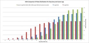

Here's a graph that show the data distribution per bit of C-log and S-log.

It's an interesting graph that kind of illustrates the effects of DR over 8 bit color. I think Canon has done a great job with Canon Log. The axis themselves are a bit unfortunate, as you might come away thinking that Canon Log wastes its maximum tonality (35 stops according to this) just below clipping. That isn't the case of course. In fact, Canon Log starts compressing pretty early into the highlights... at around IRE60 or so. Don't over expose...
It's plain to see that both Slogs were designed for 10 bit space. Canon Log is unique in that it was designed and tested, both numerically and subjectively by projection, to extract the maximum "Log like" performance out of 8 bits. Any effort to expand upon it enters into territory that Canon's designers considered too much of a compromise. Any effort to achieve the same latitude by creating a custom picture profile will be… a struggle (reserving the word 'impossible').
