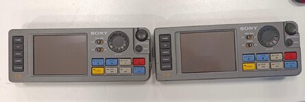

6) having a cable-remote control pad with ptofesional buttons, display etc.. along with a great viewfinder, a dockable RAW recorder (SR-R4) with 3 levels of compression, being the top aty a 3:1 ratio its incredible.
