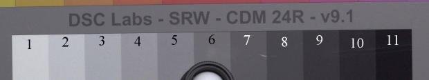

The scope shot only seems to show 10 stops of DR. Yet the chart has 11 stops of value clearly visible, without getting into whites. The dome on the light meter is another value whiter that's clearly visible. I don't think this is a valid test of DR range.

Maybe I don't understand, but here's what I see.
I see that too but I'm talking about the scope. From the output it clearly looks like 11 stops doesn't it? I'm no expert in charts though. Something's amiss here, either in the test or our understanding of it.
I think a greyscale chart with 18 steps is what you really need to measure against and they likely did. Something like this: http://www.dsclabs.com/images/New Images/GreyScales/DX1-72dB.jpg
One would expect about 10-11 stops from the FS100 though, leaning towards the 10 range.

No front lit printed greyscale chart can show more than about 6-1/2 stops DR between black and white due to the difference between maximum reflectivity of matte white media and the maximum density of black inks. The standard 11 step chip chart is calibrated in 1/2 stops for a 5-1/2 stop range. It is intended to measure the critical mid tone scale range. It takes three separate exposures bracketing 3 stops over and 3 stops under nominal exposure to get an approximate DR measurement of 11-1/2 stops. A back lit transparency chart is the most consistent way to measure the full DR of modern cameras.
