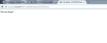

I have made the update right now from the file on the australian site, because the europe sony download doesn´t work.
an everything work.the benefit is that boot faster on startup.
http://www.sony.com.au/support/download/596979
