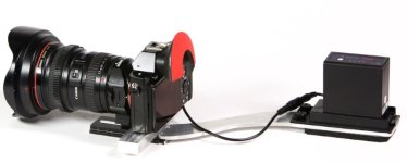

I get less than an hour out of a Sony A7s battery. But I use bigger batteries externally, see photo:
I am working on a whole kit for the A7s including a wood handle, this is part of the kit, the cable can be very long so you can have the battery in a pocket. I have the plates and dummy batteries in stock now, if you want one contact me directly. These will run the camera for 4+ hrs.

The Swit battery I am showing in the picture will run both the camera and the Shogun, I will make time tests for this soon and have it on my Webstore. I can have 2 cables come out of the plate or I can make a cable that plugs into this battery and has a D-tap end for the Shogun.
