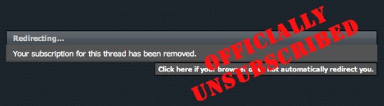

I was honestly stoked about the mini 4.6K. I knew it might have some compromise somewhere like a plastic feel, look ugly, or maybe a bad rolling shutter… but this sensor optics thing is in a whole other league of it's own.
Anyway, this will be my last post on the matter and this thread. It really doesn't matter anymore.
