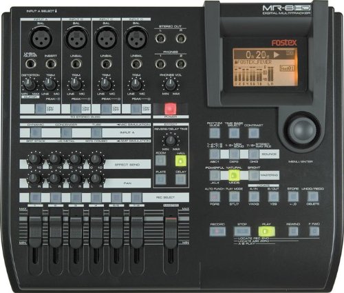

Get a second hand (no longer made) 4 input 8 track recorder, like the Fostex MR-08 HD. £150 delivered (in UK).
http://ecx.images-amazon.com/images/I/51NY2eT-mcL.jpg
It has good pres, is A4 sized, 4x 48v XLRs, records all the channels discretely. Newer one only has 2x XLR inputs!
The issues are:
1. No battery option
2. 3.5" 40GB HDD recording (noise from physical spinning drive)
3. Functionally not quite tailored for Cine use
The solutions are:
1. Rig up an external V mount or Anton Bauer battery (may take some expertise, but it has been done.)
2. Fit a 32GB SSD "Disc On Module" from ebay HK £60
3. Deal with it. It works but requires a good knowledge of the recorder, not unlike video on a DSLR.
For a low budget 4 track field recorder, I don't think it can be beat, and it is a well reviewed machine.

The issues are:
4. Only records 16-bit/44.1kHz. Since sound for video is 16-bit/48kHz, and recommended recording is 24-bit/48kHz, this is pretty limiting.
The form factor is simply too clumsy for this kind of use, and there are so many better designs out there.
The lack of remote power is also a deal-breaker, in my opinion. Sure, you could get an Anton-Bauer or V-mount rig and some batteries... but once you've done that, how much more has it cost? Enough to get something new that will suit your needs?

I use Global Media Pro Gold Mount batteries, which are much better value, and I have them and a double charger already, so I think I may well go the Fostex MR-08 HD route. It is very similar in spec to the Tascam DR680 but less than 1/4 the price, even with the DOM 32GB SSD drive I mentioned. Sure, there are aspects that are not ideally suited to Cine use, but isn't that also true of other $300 recorders?
