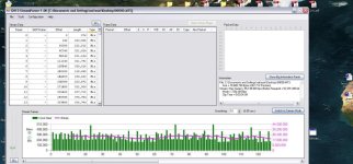

Well, GH13 Stream Parser shows all my footage as 25fps.
And MediaInfo shows the following for a clip I just loaded...
Interesting that it shows is as NTSC and it shows original frame rate is 50.....don't know what to make of this.
The footage definitely does not look interlaced since when I freezeframe I do not see any offset scanlines like you would with an interlaced footage freezeframe.

gf1 footage is 25fps but in a 50p container which means that the camera does 25fps and duplicates each frame, the option 25p native in the hack eliminates the duplicated field, this saves space on the card other than that there is no difference in the look.
