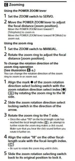

I read that the zoom direction on the 18-110 F4 can be reversed even for manual mode. Does anyone know how to do that?
I can see on the ring that there are markings on one side that are the reverse of throw other and there is a little switch that was described as being for that purpose but I can't figure out how to change anything and can't find any info on the web.
