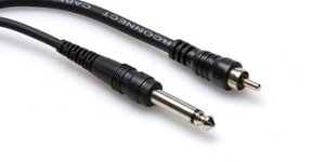

I have found the Rolls DB-25 "Direct Box" to be very handy for exactly this kind of thing. It has 1/4 inch T/S mono input and low-impedance, mic-level balanced XLR out. It also has a variable attenuator for handling all sorts of source levels. Street price around $25. I keep several of them in my stock of gear.
For a practical kit I would have at least a Rolls DB25, a long (25 to 50 ft) XLR cable or TWO, a RCA to 1/4 inch phone cable, and an RCA to 1/4 inch adapter. That way you are prepared to get audio from XLR (direct into your XLR cable), from RCA using the RCA-phone cable and the DB25, and from 1/4 inch phone (with the addition of the adapter).
