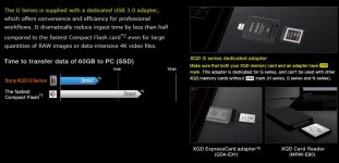

That's what is kind of odd. All cards seem to work fine with my Lexar card reader, but only the Sony G cards work with the card reader that comes with the Sony G card, even though they are both USB.
Sony G-Series Ready Works Only with G-Series Cards QDG128A/J & QDG64Q/J
Sony confirmed that the G-Series Reader supplied with the QDG128A/J and QDG64A/J is dedicated to G Series cards only that have the USB mark.
Cards without the USB mark do not work in the G-Series Dedicated Reader:
H Series
S Series
N Series
Lexar
The Sony MRW-E80/BC1 Reader $39 is what you need if you plan on using the slower H, N, S, or Lexar XQD cards.
Sony G-Series Reader works with only G-Series Cards or Cards mark with USB on the Card Texas Med.jpg
