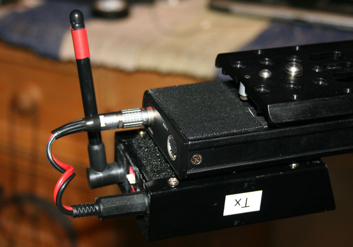

Here's the setup I use:
That's just a regular 12v output port [3-pin Lemo 0B connector] on the Steadicam camera stage.
- Mikko
