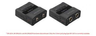

On a side note, it's not exactly what you're looking for but the DR-10L is popular for the price (and its safety track).
https://www.bhphotovideo.com/c/product/1281085-REG/tascam_dr_10l_mini_portable_recorder.html
AFAIK the european version of this records and simultaneously puts out a signal which can be fed to a transmitter e.g. Sennheiser (or presumably a cheap bluetooth for monitoring only). https://www.amazon.co.uk/Tascam-DR-10CS-Connection-Lavallière-Microphones/dp/B00QV8L586
That's pretty much what this thread is about...USA vs. other locations.
You can't get that version - the DR-10C - shipped to the USA (at least not legally).
We have the DR-10L here.
I recall the DR-10S (hence the Zaxcom v Teac n/a patent infringement case) was the version with the throughput to a G 100 series Sennheiser Tx. the DR-10L (Lectro) was discontinued all together
The patent is waste of time because most G series owners would not be purchasing the Zaxcom anyway due to the price difference, and makes it more difficult for folks w/o large gear budgets plus alienating potential Zax customers as well. (Sorry Glen)
From the 10C series, the 10CH and 10CS were the ones overseas.
But the CH was discontinued, while the 10L in the USA [with only internal recording] is a strong seller.
