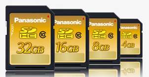

For my Canon SX1 I'm using cheapest SDHC Class6 cards - and all are fast enough.
SX1 makes 43 Mbps (!) H264 - same like Canon 5DMkII - with 1920x1080. This are 5.4 MBps - EACH Class6 (guaranteed 6 MBps) are enough!
If someone has to much money: buy a new Class10 card :beer:
