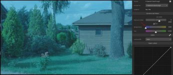

Recently I've come across a strange WB green bias in a couple of my clips shot with Slog3/S-Gamut3..Cine - is it something connected with some new settings brought in by the v4.0 firmware? Are we now able to influence the WB in any way shooting in CineEI mode? TIA
Piotr
PS. Here is a screen grab from how it looked like in Browse before any CC; note how the WB slider is all the way to the left and how the original footage is tinted...

ok so have you opened it in an NLE to see if it is just a metadata issue? is it fine in premiere/fcp/avid etc?
I'd reset the camera and make a new master all file, and reinstall catalyst, which is a hateful piece of software anyway :)
Yeah, you're right abot Catalyst - which is a pity,a s it could be a very nice tool for initial clip assessment and ingest.

Oops - sorry, didn't notice your last post; thanks. So it must be metadata handling by Browse - all looks normal in Resolve or Vegas Pro.

PS. Regarding my original "issue" in my OP of this thread, I'm taking it back; in a moment of some brain blackout (or simply having one cup of coffee too little in the early morning), I all forgot that Catalyst Browse will keep the latest settings of all CC controls, and use them the next time it's launched - even when entirely different clips a e open. So the |green tint" has nothing to do with my camera - I simply must have played with the WB slider in my previous session... All is well in Resolve - no green tint whatsoever :)
