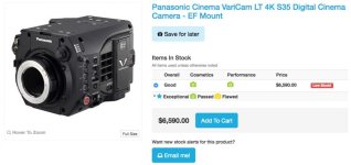

Now under 10k. I just bought a used one, but I’m not mad because it came with everything I need to shoot. I agree with the article, at this price the LT is head and shoulders better than cams in this price range.
