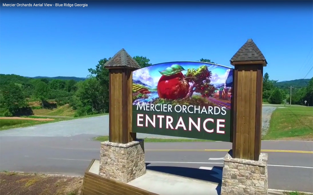

Essentially with a polarizer it helps to take all that reflected light away so your not trying to stop out the sky or add more light to the subject. We published a magazine for R/C helicopters and drones for 19 years which required most every shot to be in the sky and a polarize filter was a bare necessity. Not saying you can't live without one but well worth keeping on in your bag.
Here's a video capture of a drone shot for a job we did with a polarizer - that sky made the shot!
Regards - Mike
