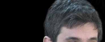

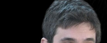

I am having a really hard time seeing the difference that 10-bit is supposed to make for chroma-keying.
EDIT: I don't actually mean 10-bit, I mean 4:2:2.
Here are two screen-grabs at 400% from my NLE (Premiere) using Ultra Key's default settings for both. Can anyone else tell the difference between the 10-bit ProRes 4:2:2, recorded via SDI to Blackmagic Shuttle, and the 8-bit internal recording? Obviously, I can refine the edges, but when I do, they still look the same to me.
Am I missing something?
The difference in 10 bit vs 8 bit is usually not apparent in the untouched footage. (Though the difference in compression between xdcam and say prores from an external recorder can sometimes be seen). Typically, the difference in 10 vs 8 bit is very obvious in gradients when heavy contrast is applied in post grading. So in your examples, add a bunch of contrast to both shots (pre-keyed) and you will likely see banding in the 8 bit and smooth gradients in the 10.
8 vs 10 doesn't really affect chroma, but color space (4:2:0 vs 4:2:2) does. You will notice a difference here if you have a tough key to perform.

Hey folks, thanks for weighing in. Point well taken about 10-bit vs 4:2:2, my title was misleading. My problem, however, remains.
The two screenshots I posted ARE greenscreen, that's what I'm talking about, not bit depth as my title suggests. One grab is from the internal coded, the other is from ProRes HQ recorded via SDI on a Shuttle.
I cannot, for the life of me, spot any difference in the key between the two methods, and I am hoping that it's just because I'm doing something wrong. Has the necessity of 4:2:2 for chroma keying been oversold?

I thought that I had finally found the difference, but it turns out that was just because I accidentally applied the grade before the key in one of my examples.
Here are the two, 4:2:0 and 4:2:2 chroma keys side-by-side, with some motion this time.
Try it again with someone who has very frizzy hair.

Guys, come on. Look at the green-screen example I posted. The key is not too bad, right? That's not the point. The point is that its IDENTICAL. One is 8-bit 4:2:0, the other is 10-bit 4:2:2.
Can nobody point me to any concrete, comparative examples that really show the real-world difference 4:2:2 makes for keying? I understand the theory, but based on my results I'm not convinced.
Look at the single hair sticking out of the top of his head, for heaven's sake.
