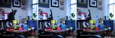

Recently i added a few LitePanle LEDs to my lighting kit so i wanted to learn a bit more about their properties (their color tint, how they respond to gels, how powerful they are). I set up 3 different lighting instruments: an HMI (LTM 200), a tungsten unit (Arri 650) and LED 1×1 (LitePanel 5600k Flood) unit and lit a scene. Now all those 3 lights are totally different instruments that have their strengths and weaknesses here they are being shown in very narrow test.
Camera used Canon 7D. All lights were placed 6 feel away from the table (for each picture each light was placed on the same stand). ISO was adjusted to provide more or less similar illumination from one light to another.

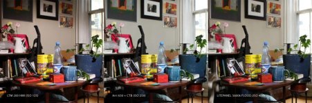

Here are 3 screen garbs with WB set to daylight (Arri gelled with CTB):

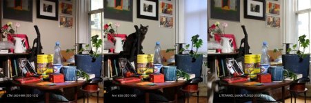

Here with WB set to tungsten:

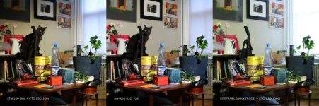

And here to tungsten (HMI and LP gelled with CTO):
Conclusions:
- gelling any light other than tungsten produced unexpected results (some color shift)
- tungsten produces most natural colors
- LP in its native colors (here 5.6k) produces surprising good colors
- the bulb of this HMI is probably too fresh as it shows too much magenta (but i’m too lazy to redo the test with another HMI)
- when gelling lights it’s the fringes that show the most color distortions (see high res images below for better examples)
- 200 HMI is equivalent to 2x 650 with CTB !
- gelled, LP becomes almost unusable as 6 feet away from the subject the ISO has to be pushed to 1000!
- generally it’s best not to gel lights that are used as key to light your talent (unless going for an effect)

I'm quite confused as to the point of this test. It simply proves that all three on their own can do a pretty decent job. The only slight issue is adjusting the outputs to match each other, and the usual technique is to gel the brightest source, as you can lose the brightness without issue. It's clear the LED panel is the softest, as you'd expect from the big source. What I don't understand is that in the second set, with wb set to tungsten, they are all very blue - the arri should have been warmest, but wasn't - but in the last set, the arri warms up, yet you didn't change it? As it stands, the arri on a tungsten setting should have given the reddest but didn't. Are you sure the pics aren't mixed up for the Arri?

The years Paul, the years....Your eyes must be getting weaker... You didn't see the label with tungsten white balance where it says Arri is gelled with CTB?
This test shows quote a lot to me:
- Finally for sure i know that 200 HMI = 650 tunsten (more or less)
- Gelled Arri is a great contender to daylight based source
- Gelling anything other than tungsten produces funky results
- Even quality instruments are best used in their native color range (for natural look)

No - I meant in row two - wb set to tungsten, the arri pic in the centre is clearly blue? I'd have expected it to look like the one below - with the better red/yellow result. Row two centre looks like it has ctb on it. Have I lost the plot? (Quite possibly I have, and it really is age!!)
I think you are on the blog where it somehow never updated the mid image (where it says that Arri was with CTB - thus ALL the lights are blue).
