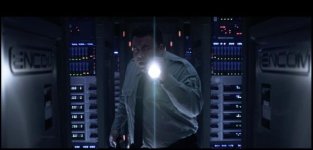

Did anybody encounter any smearing issues with street lamps for example or car lights?
I'm wondering how the CCD sensor of the f35 performs about smear rejection. The specifications of the f23 say -135db but I found nothing about the f35.
The best example of smear is to watch TRON: Legacy, especially the first 15 minutes or so before he enters the computer. The smear really just looks like vertical lens flares--I quite like the look, actually.

Hi Periferic,
The only things that I think will smear the F35 are the sun or a bright source pointed directly down the lens (eg. flashlight, camera flash). Streetlights are nowhere near bright enough, even if you point right at them.
I can see that being looked at as cool or trendy and people even thinking it was added in post, after all the JJ Abrams antics. :grin:
