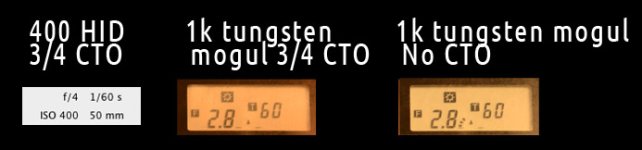

Yeah, it's bright as hell. My tests with gels, diffusion and blocking off a lot of light got me F4, 1/60th, 400iso.
Here's a comparison with a 1000 watt tungsten mogul, same position, fixture, diffusion, and gels (and without gels). This sucker is a full stop brighter than a 1000k tungsten on the HO setting - that's about a 2000 watt tungsten equivalent:
