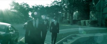

I did a music video where I needed a group of sort of matrix-agents to walk by the camera. Had one guy in costume walk by the locked-down camera (tripod). Shot some handhled reference, right there from my camera position (took the cam off the tripod and shot the tripod handheld).
The locked down plates made it easy to composite the 3 guys into 1, without much roto. Then I tracked the handheld, and used that footage to make the shot "handheld" by using real handheld data vs faking motion. Shot a lens flare with a black card and a hole punch and tracked that in with the motion.
Came out great, post was very fast, and the handheld look "glued" the comp together really nicely. So, plenty of reasons to shoot locked down for a final handheld look.
