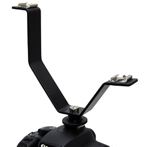

Another option multiplying shoes:
http://www.thej-rod.com/Jrod/Home.html
He custom-fabbed a twin mount that I used to replace my (missing) mic holder, and it's worked spiffily.

I recommend the J-Rod Cube. mcbob posted the link to the website above. It's a simple and very solid solution, maybe a little bit pricier than others but really useful.
I'll third the J-Rod Cube. BUT, it's a shoe mount device, which you said you didn't want. Should you reconsider, I would highly recommend it.
