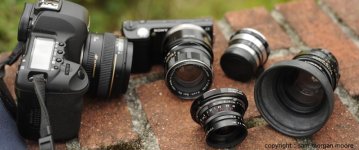

Here we see the Canon 50 designed to clear a mirror and cover a fullframe chip looking bloated compared to some lenses designed for mirrorless cameras..

Hanad - my picture shows voigtlander lenses on an NEX5 - so yes adapters exist
