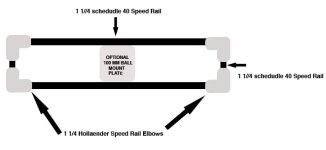

I think these plans may explain this slider a little better ;-))

Paul, this is great. If it's not too much trouble, could you give us the dimensions of the slider platform and the separation of the rails? I'd like to build one just like yours, thanks.
