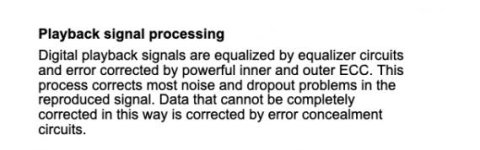

These are the only possible mentions of it I could find in the manual.
