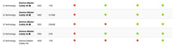

According to Atomos' support chart, the G-Technology SSDs have the highest amount of drives that have either been untested or have failed (red dot...but they don't tell you which one) at certain resolutions/framerates:
Only the Angelbirds (besides 1 test for 1 SSD) and all of the Sonys appear to be flawless:
https://www.atomos.com/drives
