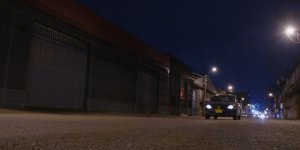

Still image from video of ISO 3200 image, all natural lighting. Notice the sky, full of noise
That's too compressed to be able to tell anything from it.
And we need motion so we can see the amount of noise dancing that's taking place.
I know, but if you look closely above the car you can see that the sky is not uniform as it should be, it is full of huge grain (noise). It is not from the compression of the photo, it is there in the hi-res version as well. Let me check if I can post a video

IMO, what you have looks like compression blocks/artifacts, not noise...
The focus also looks to be on the concrete and not the sky, which would blur the sky and could mess up the image based on the circumstances (night time, multiple lights, shallow DOF).

Once we hade both cameras we did some tests in exterior low light and came to the conclusion that the Sony A7s ii's noise is more or less equal to the BM 6K Pro's within ISO's of 800 to 3200 (using SLog2 on the Sony), so we kept shooting with the BM, since it has many other benefits. Not sure if our tests are thorough enough, so make your own in case you have a similar situation... Something that also became evident is that the natural "noise" of areas out of focus will get especially noisy in low light using ISO's over 800 (like someone commented). Another consideration is that noise will be more evident in locked-down shots than moving ones. Still learning. Thanks for your input
