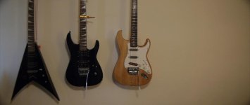

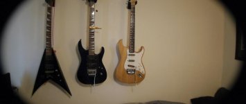

Here are two stills from a video I just took on the GH2. The first one is the 14mm pancake and as you can see, it vignettes pretty bad. The 2nd is with the 20mm pancake and there is a very slight vignette. When i was using the 14mm on my BMPCC, I could use the adapter with the 14mm and no vignette, but that is 2.88x crop. Unfortunately, I do not have a zoom lens wide enough to test 17.5mm, but it would be very very close on the GH3. I believe the GH3 is more of a true 2x crop when the GH2 is a 1.86x crop. Given the difference in focal length from 14mm to 17.5mm and the additional crop, it may have a very slight vignette. Sorry I cannot get you an exact answer, but this should be a helpful guide...14mm.jpg20mm.jpg
