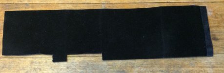

Looks more like a hood than a loupe are u considering a viewfinder to fit over the LCD?
Olof,
What is is the photo in the above post is a hood I made, it is made from laminated fabric, inside is Velcro fabric and there is plastic stiffener between that and the Velour on the outside. It is similar to the Odyssey hoods I make. Here is a photo of it laid out flat, it weighs just a few grams:

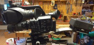

Some shoulder bits coming together, we are just playing around with ideas this would be the traditional ENG setup with Brick battery and Loupe on the LCD:
This is incredible well balanced even W/O a handle extension. But I will be making that as well. You don't have to use a Brick battery, I have a bag I sometimes use on some of my kits instead. Or we could mount an Odyssey or other recorder back there, It would balance nicely as well. This comes off in seconds.
Any comments are welcome...
The Hoodman Loupe looks very promising. Do you think the LCD strong enough to hold it in place and not put any strain on the ldc?
I spoke to Kinotehnik who make the LCDVF's and they are not considering to produce one for the FS5.
Olof, your shoulder mount looks a bit awkward but if u say its well balanced thats great.
